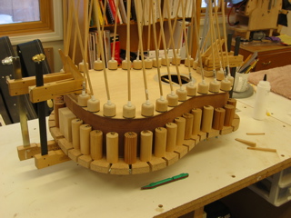

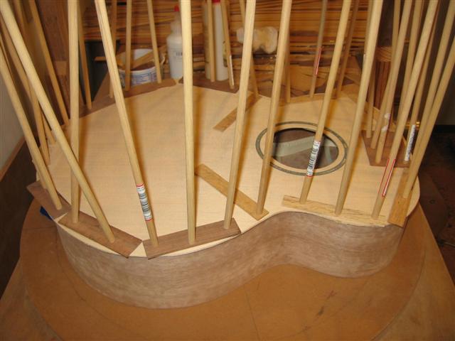

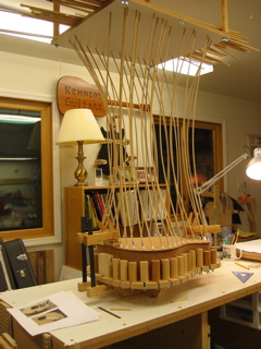

Ross, here are a few more pics of top gluing to sides on the recent OLF SJ 2 Team Built guitar.

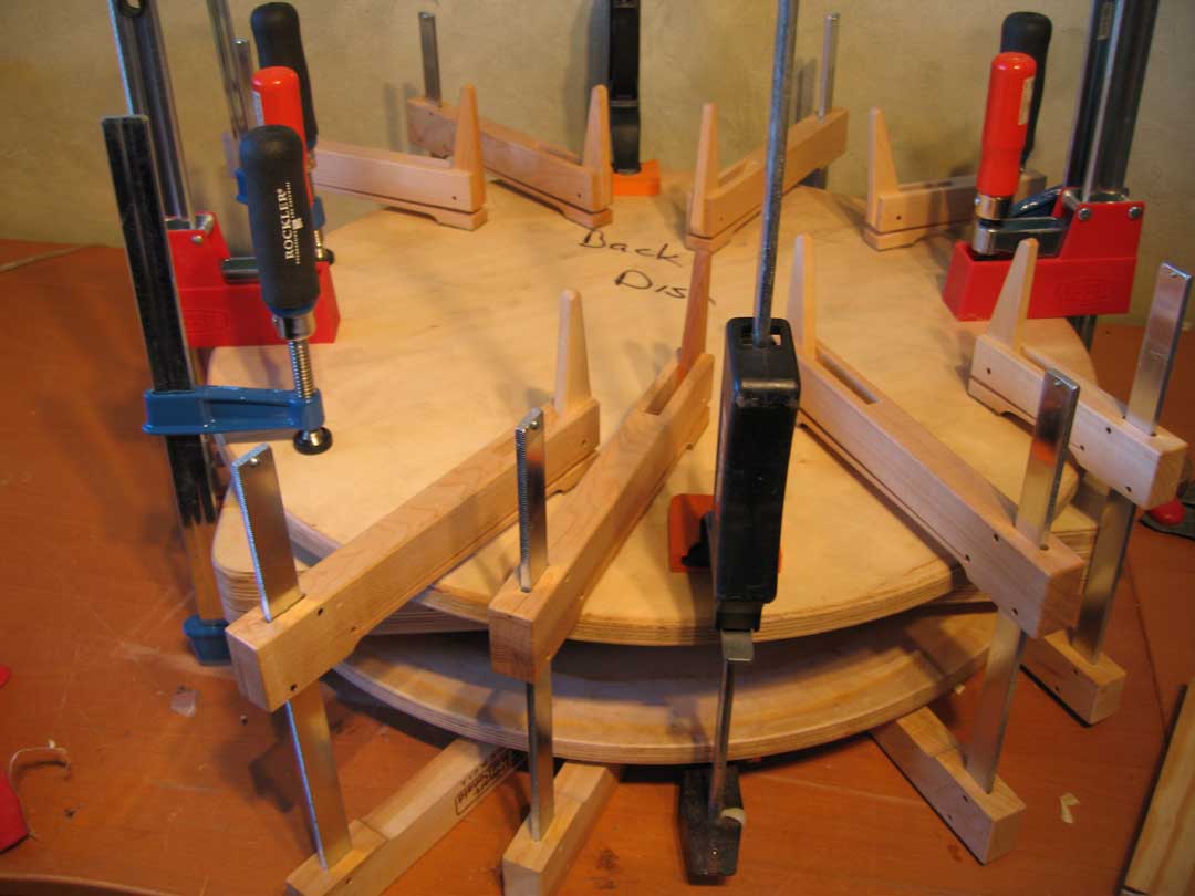

I use my radius dishes as clamping cauls.
Fits like a glove.

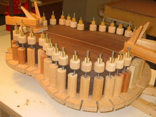

[QUOTE=terken] I used to use speed nuts with half of a spool clamp but the back and
sides had to be very close to actual size for proper clearance. On the last
couple I have used go bars also. I like this the best. I use part of the
spool clamp to protect the top.
This is very cool Terry, i've seen this example a couple of times on the net and it makes perfect sense if you build more than one size guitars,. Is it possible to buy the spool clamps at any hardware store or i should look at a more specialized woodworking store like Lee Valley for instance?

[QUOTE=azimmer1] I use my radius dishes as clamping cauls.
Fits like a glove.
Vey cool idea too Andy!

Go-bars and a ID OD template out of hardboard. OD to match the the shape ans ID about an inch to inch and a quarter insude the body shape. This is a clamping caul for the go-bars to use and prevent divots caused by the bars.
By far go-bars are the most user friendly way. Much easer to varrify alignment. Spools are ok but time comsuming to get clamped down. Go-bars are a flash
PostPosted: Mon Apr 03, 2006 4:11 am
I like the spool clamps for many shapes but as you mentionned Michael, for the go bar, a ID OD template out of hadrwood sounds safer. Many ways to skin a kitty, i guess one with more experience with spool clamps doesn't feel uncomfortable or unsafe vis a vis divots?
